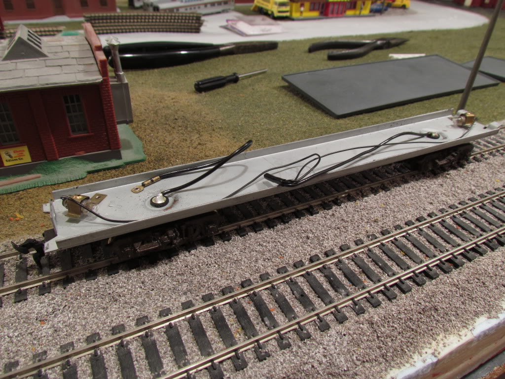

This isn't anything terribly exciting or ground-breaking, but I thought it was worth noting. While disassembling my Rapido fleet for cleaning, I noticed Tyco went to the trouble of using different bulb configurations based on the body style. Take a look at the coach:
Nothing new here....two bulbs, one at each end. The bulb fixtures are riveted to the chassis in between a pair of indents. While cleaning the coach, I noticed a third hole and set of indents near the center of the car. Was Tyco planning on putting three bulbs in their cars? I was stumped...until I opened the combine:

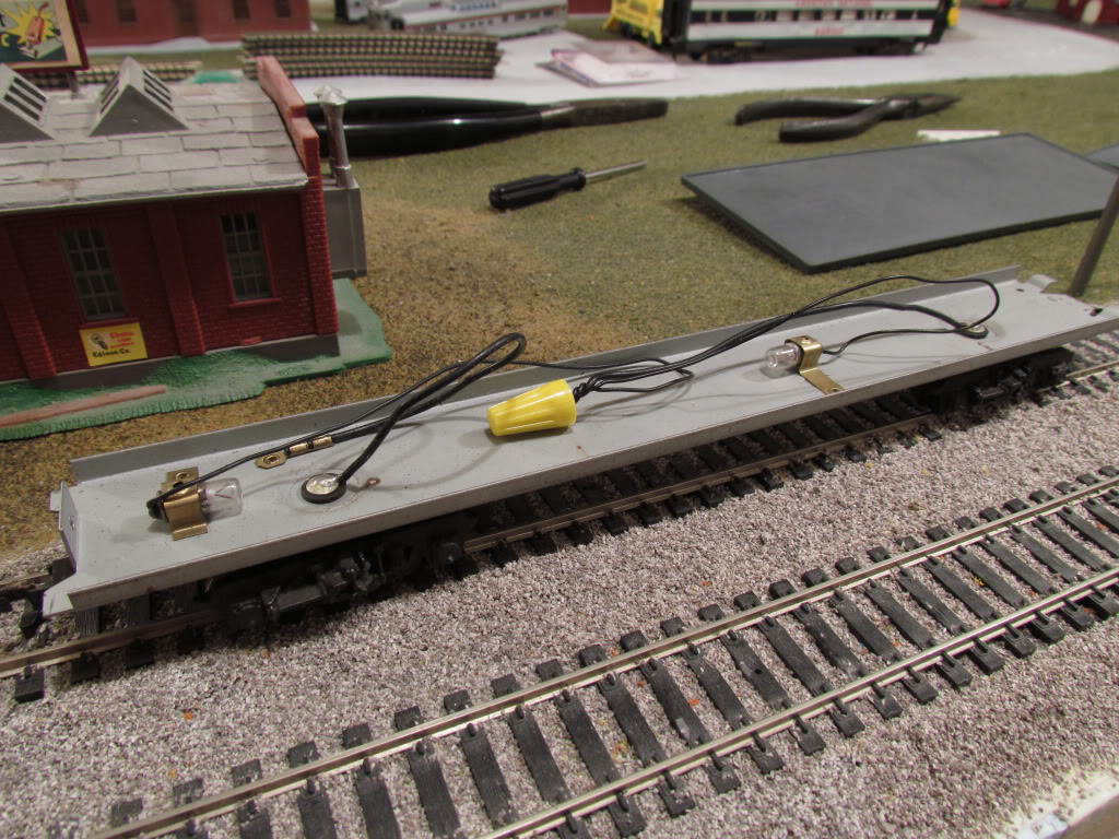

...And now it all makes sense! The bulb was positioned near the baggage door. No sense in lighting the end of the car with no windows
This isn't groundbreaking, but I do have to give Tyco props for the multiple lighting configs. Looking at my collection, it would appear Tyco discontinued this practice some time in the late 60's. About half of my Tyco sets are set up like this.

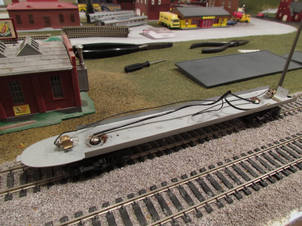

Here's the observation for reference. It has the rounded end:

The lights are out in my Mantua/Tyco s/l obsv. How do I remove the body to change bulbs?
caboose 1
 Posted - January 13 2013 :  02:03:35 AM Link directly to this reply  Show Profile  Click to see DaCheez's MSN Messenger address  Add DaCheez to Buddylist
Your car has the metal chassis like in the pictures, yes? At the rounded end there is a metal tab that fits in to the shell. At the other end there is a screw. First remove the screw. Gently pull the metal chassis at the screw-end out of the body. Once the chassis at the screw end has cleared the body, slide the metal chassis forward until the metal tab comes out of the body.
I hope that made sense. Life-Like makes bulbs that are drop in fits (item no. 1213). Good luck!

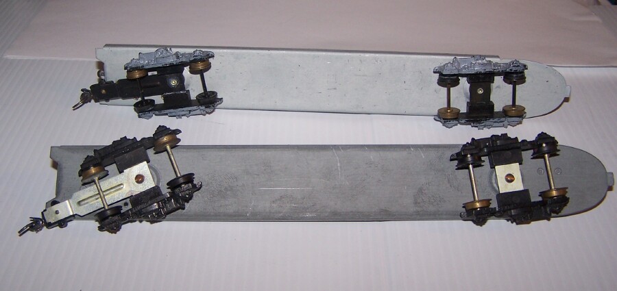

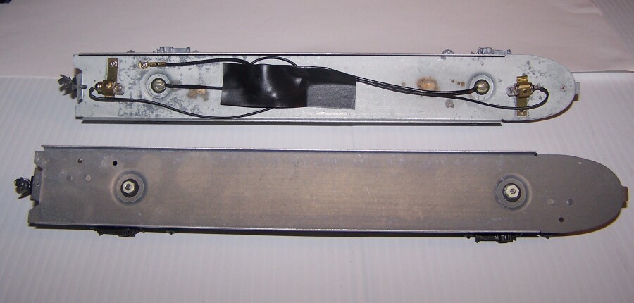

Not true. Like Ben, I have several streamliners WITHOUT the wiring. Here's the proof below. Looks like it was an option. I noticed that the unlighted Obs car has a clear laminate with black shadow people, but the lighted car has a white laminate with black shadow people ( so you don't see the wiring and bulbs? ). The holes are there for the electrical connections but there was nothing there and no scratches to indicate anything was removed. So obviously they cheapened them up later on ( Amtrak 70's Tyco era ? ). And no solder on the nuts, although they probably would have used a small ring terminal instead of soldering them. So Ben is correct, some came without lighting installed.

Hey AMC. The bottom car in your picture is a kit-built, while the top one is an RTR. The screw-on trucks are dead giveaways. Tyco sold a lighting kit for the streamliners which apparently didn't always get installed In the kits the builder was instructed to cut pieces of paper to fit inside the car and act as the translucent window backing. I believe sometime in the 70's they ditched the paper and made the window bands translucent instead.
Let me rephrase what I said earlier. All of Tyco's RTR streamliners should have come from the factory with lighting installed
