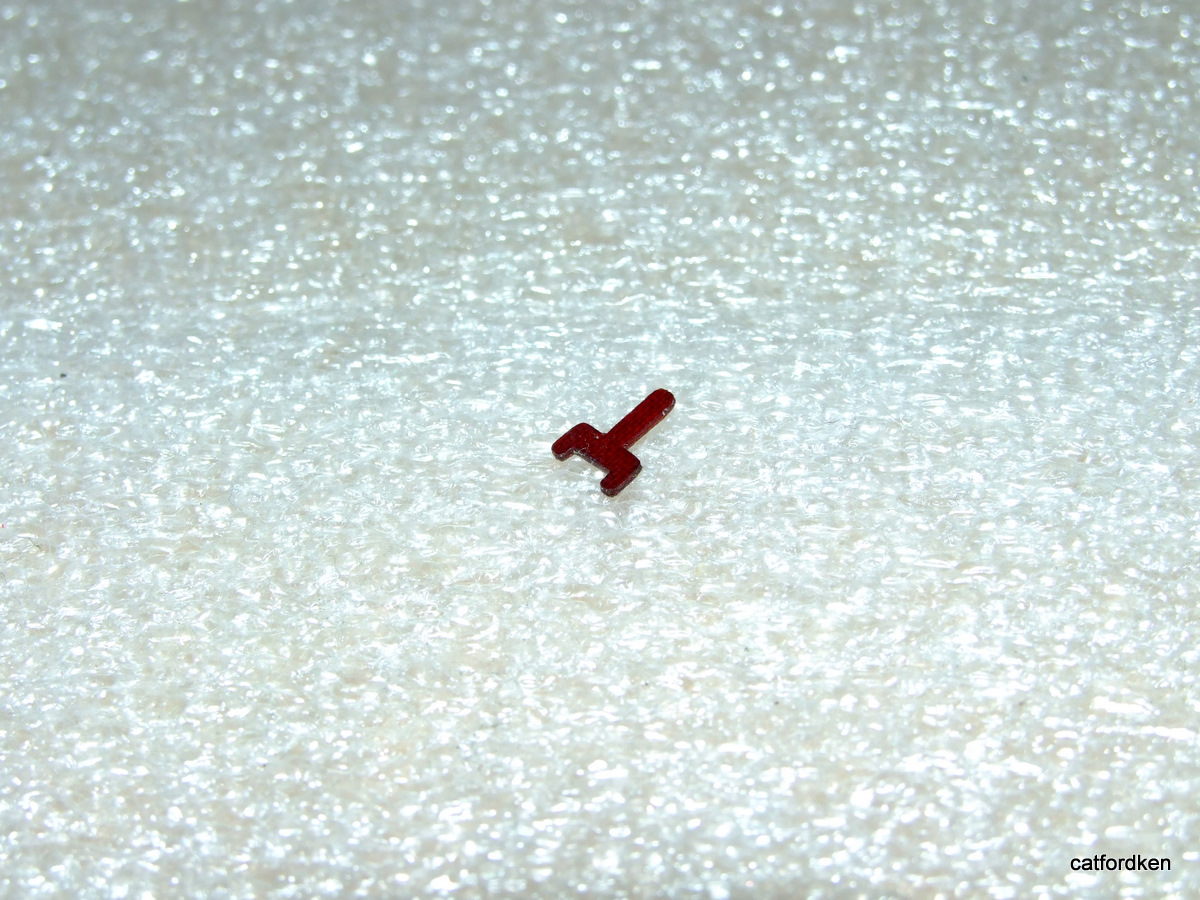

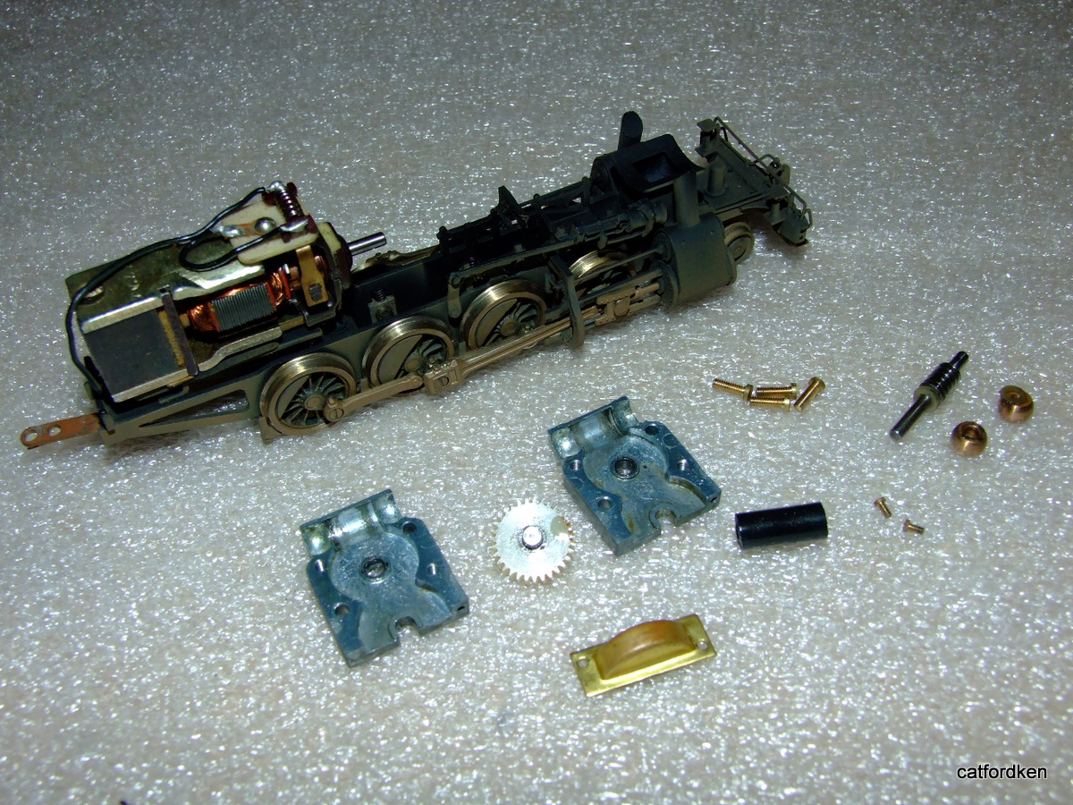

spent weekend cleaning my balboa up,left it sitting on side,came back and the spring that holds bushes in place came away from motor,found spring and one end piece as in second photo,so unless i can source one,or make one (original is a bakelite type plastic) am up creek without paddle,ken

 Posted - September 04 2011 :  1:33:20 PM Link directly to this reply  Show Profile  Send catfordken a Yahoo! Message  Add catfordken to Buddylist
hi gareth that piece is about 6mm from longest end to end,for his costs it would most likely be cheaper to buy new motor,which would be a real shame considering this one is not even broke in and original ken

Couldn't you cobble something together on your bench...you already have a pattern.
 Posted - September 04 2011 :  1:58:19 PM Link directly to this reply  Show Profile  Send catfordken a Yahoo! Message  Add catfordken to Buddylist
that small with my eyes,goldfish bowls as my kids call them,thought about it but its so thin,plus i have seen that shape somewhere used for something else ken

 Posted - September 04 2011 :  1:59:45 PM Link directly to this reply  Show Profile  Add toptrain to Buddylist
Ken : use plastic sheet, hard cardstock or thin wood. Make 2 or 3 using the remaining one as a pattern. Match the thickness, 2 or 3, and glue together. It may work.

Hi Ken,
I had the same problem I make one out of an old circuit board. Took some time but worked great.

 Posted - September 05 2011 :  12:23:56 AM Link directly to this reply  Show Profile  Add NickelPlate759 to Buddylist
Ken has the right idea, because those parts are made of phenolic, which is what circuit boards are made from. You might be able to cut and file a piece of scrap PCB to shape.
