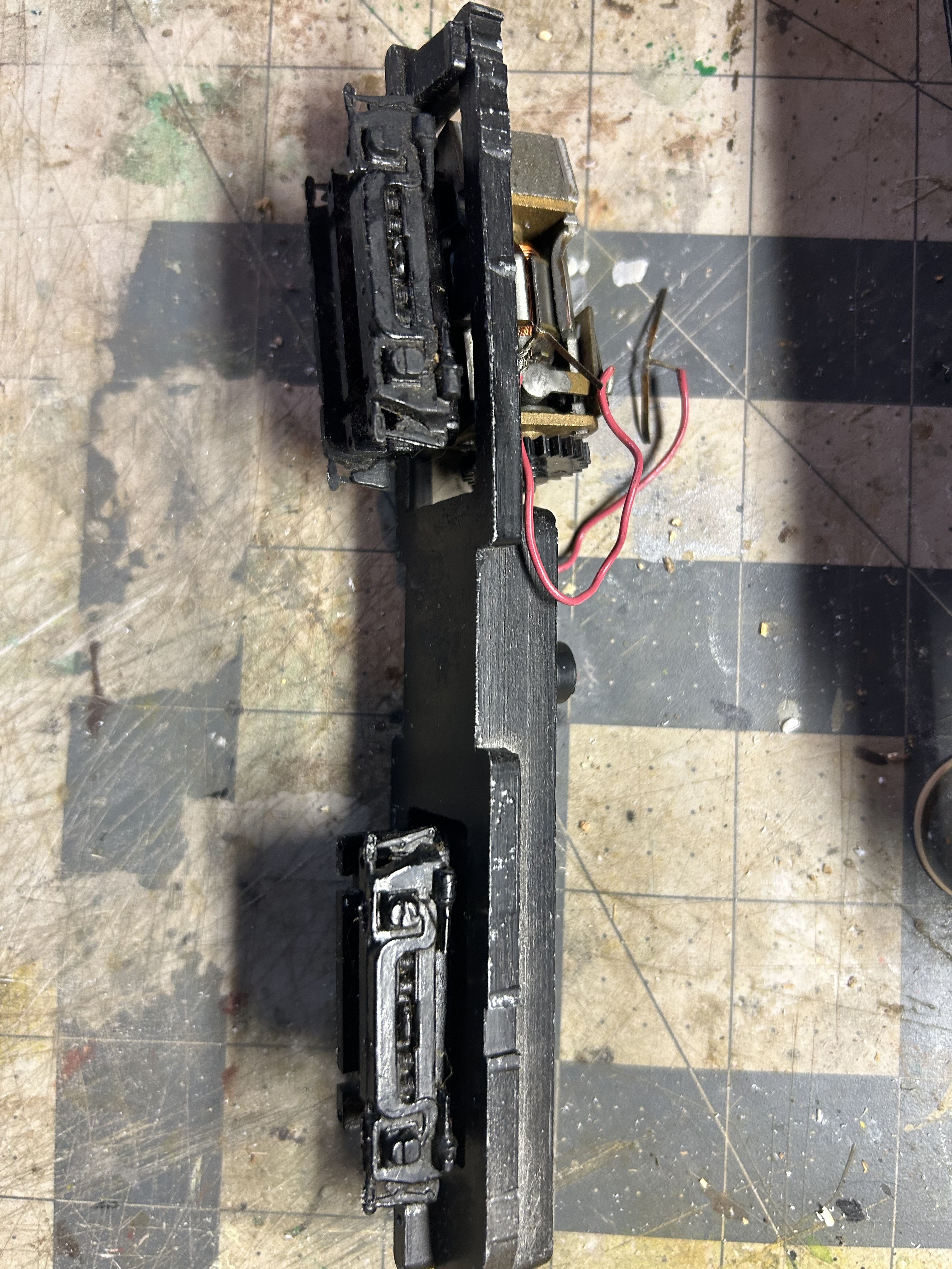

I recently bought a box of HO engines, rolling stock and track at a yard sale for $15.00. At the bottom of the box was a nice pair pf PRR A units, one powered and 1 dummy. I am not sure of the manufacturer but I THINK it might be HobbyTown.
I am trying to post some pictures but the. jpegs won't go through. The motor runs very well but, all of the gearing, wheels and truck covers are missing. I have been searching for these parts, with no luck. Can anyone suggest where I could get the parts to put this guy back together?

Hobbytown should be meta bodies with a "tank drive" where the drive shaft connects the trucks below frame level. The motor would sit on top of the frame with a gear tower at one end. If this is your setup, then try https://hobbytownofboston.com/ for a parts list. He still makes the kits and parts for these.

I think I was able to get the photos loaded:
Any help is appreciated. I will look into the Lebanon guy, thanks.

That's a tank drive, but it's not a Hobbytown. The motor is truck mounted. It also looks like it's the drive for an Alco FA. COuld it be a Hobbyline/ John English unit? Here is the parts diagram. Note the setup is VERY similar to a Hobbytown unit, but the motor is truck mounted rather than frame mounted.
Hobbyline FA diagram
https://hoseeker.net/johnenglish/johnenglishalcodieselpg1.jpg
Hobbytown FA diagram
https://hoseeker.net/hobbytown/hobbytown206Kalco8w1600page1.jpg
