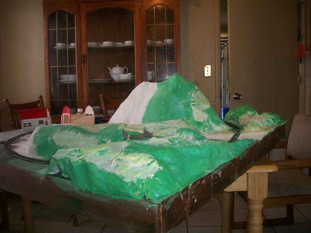

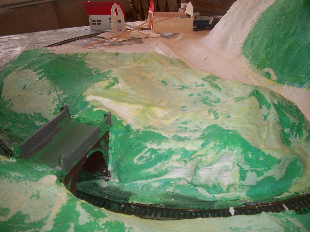

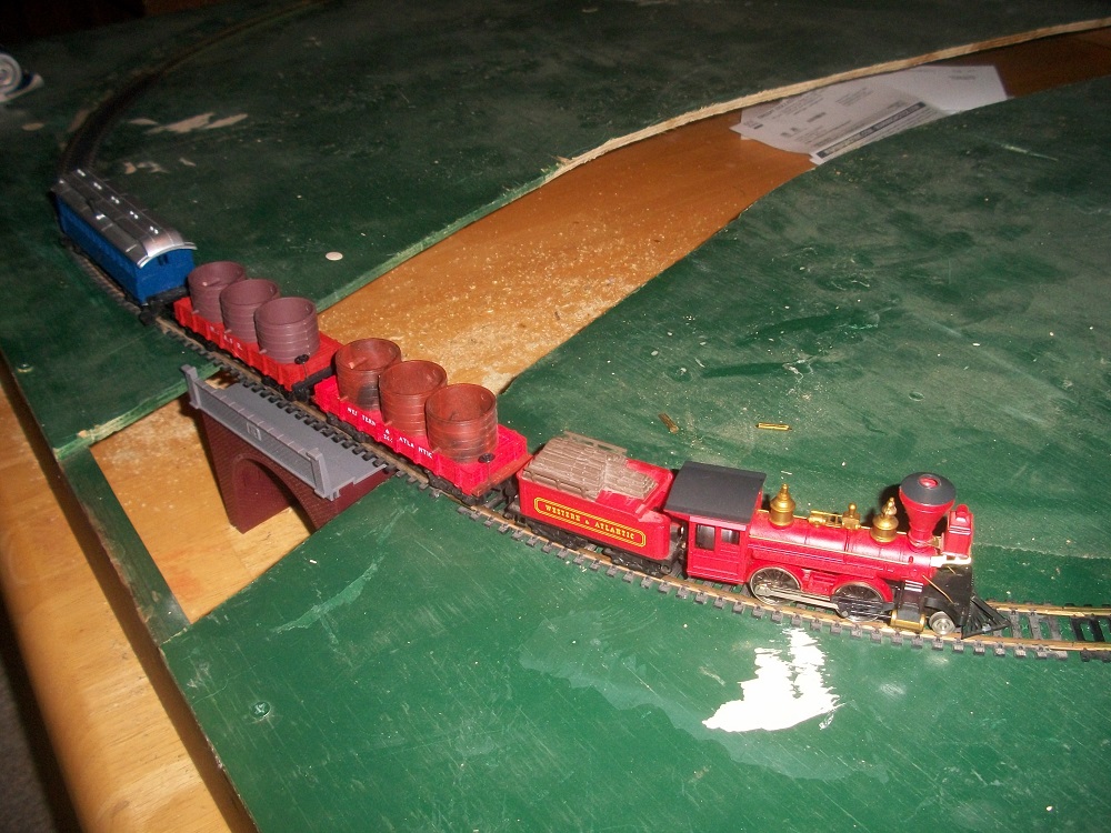

From this:
Unto that:
Mt. Teapot can be seen in background. In foreground is a rough approximation
of Mt. Sugarloaf, Sunderland, Massachusetts, where I enjoyed many pleasant years,
and my middle daughter Isabella. The snow is a portent of things to come...

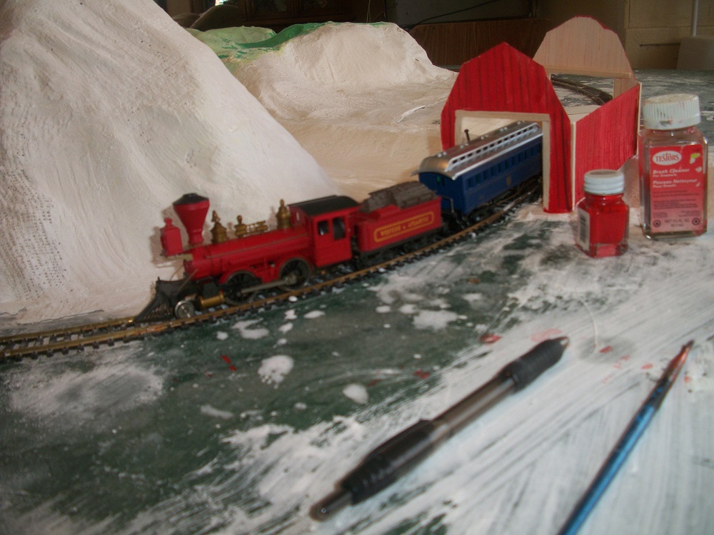

My eldest daughter remarked, "cute farm." It is NOT a
%@#$%@#$ farm, but a model of one of the few extant
covered railroad bridges spanning the Connecticut River
twixt New Hampshire and Vermont.

why a train goes thru a barn
Cause the ROW went right thru a farm & the farmer was not happy about it

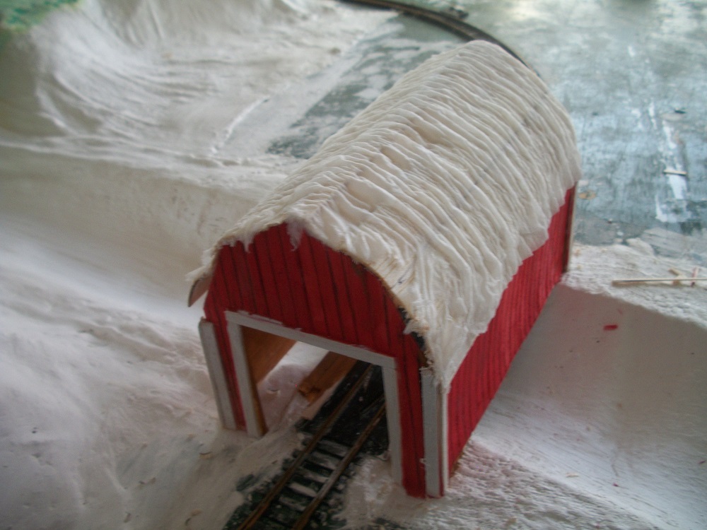

Toilet paper laid over a thin wash of white glue. Snow on roof.
For those wise crackers in Nebraska, it is a called a "covered bridge." Usually
used in horse and buggy days to keep horses from freaking out when crossing
over water (which they will do, I have the bruises to prove it).
Once actually used once or twice by railroads in or about Vermont, why, I have
not a clue. Perhaps railroad locomotives jump hysterically into the air like
their horse predecessors.

First of all, I was delighted to see a model of a covered bridge.
The main reason for covered bridges (and it need not involve spooky horses) is that a long span requires complex truss work with lots of joints between timbers that hold moisture and promote decay. If you build a building over the whole shebang, the truss stays dry and lasts indefinitely.
