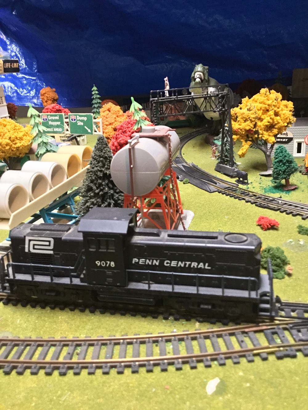

Yet another reason to go with Penn Central. Many times, one can simply strip the overcoat paint
off and end up with a perfectly black shell. I save thousands using this method.
