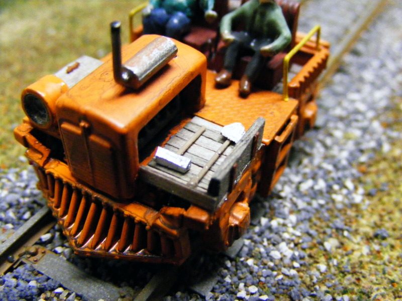

Coming together! The front tool area is planked off with some bass wood I cut. Took forever to figure out how I was going to do the front end. Ended up cutting up a pilot off a old IHC steam engine. The cow catcher went up front while the other parts went to the rear.

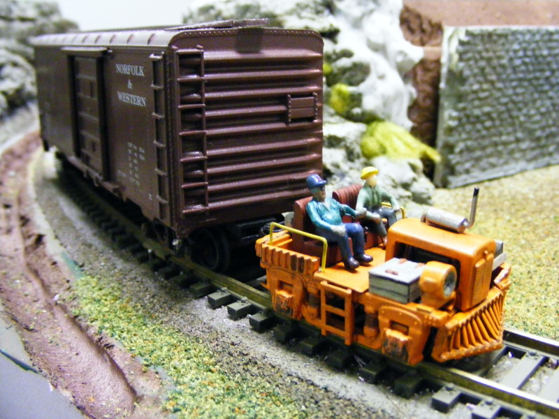

First shot of the crew out on the rails of the rental layout! Headlight was cut off a old tyco/mantua steamer I believe? Then filled with glue to give a lens effect. Boxed in the tool area with some more wood. Staples served as handrails haha. I forgot to take shots of the rear. There is a working coupler back there in case a rail car needs moved or if the critter is being towed.

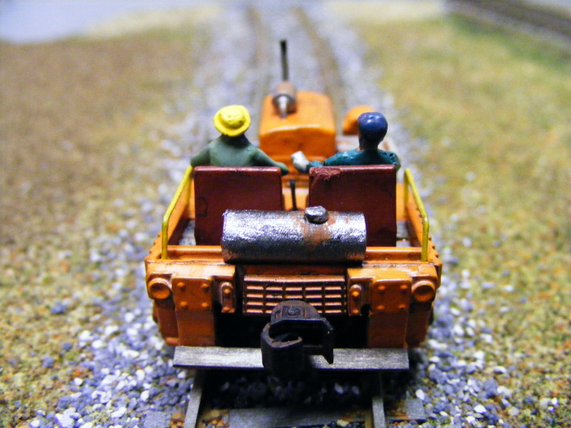

So few more shots. The tools are done, not bad for scrap pieces! The back end I didn't have as much focus on what I wanted it to look like as I did with the front. It worked out in the end and I lucked out with the coupler sitting at a useable height. (Camera went a little color nuts on me sorry about that, its a lot more toned down in person).
Here is a fun size comparison. The smallest piece of rolling stock I own is my cut up Tyco tank car from the kitbash contest we did on here a few years ago (which I still need to finish ). But its alive and well, and here it is DWARFING the speeder.
Even a 40' boxcar towers over it!

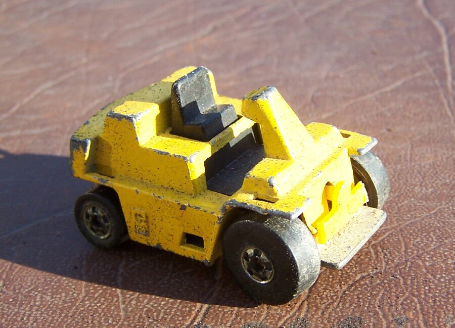

While at an antique auto flea market yesterday, I picked up some diecast vehicles and among them was this one, a Hotwheels forklift ( or what's left of one ) from 1980's
I'm thinking of turning this into a MOW vehicle, actually more a yard mule for lightweight or empty freights to move them around. Why tie up a full-blown engine for that?

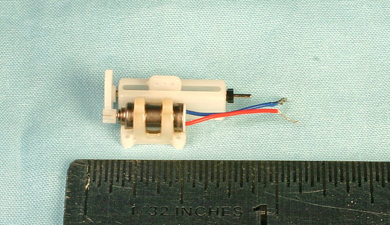

Here's a pager style motor that someone modified to fit on a truck axle. I thought I had pictures of it mounted, but I guess not.
This was from a motorized variable resistor, like a remote volume control. The housing and reduction gear were opened up to fit the axle, and it just hung on it. These motors are only about 1.5v - 3v, so you'd definitely need something to step the voltage down. No room for a decoder, tho, unless you put it in the MOW car behind it with flex wire to the speeder.

 Posted - August 08 2023 :  7:57:39 PM Link directly to this reply  Show Profile  Add wks to Buddylist
"So few more shots. The tools are done not bad for scrap pieces.
It worked out in the end and I lucked out with the coupler sitting at a useable height."
