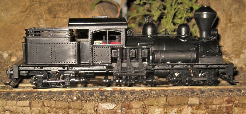

A friend of mine picked up a kit for a Shay locomotive at a garage sale. It was a 3-truck shay, partly assembled and with missing parts. He did not figure he could complete it, and passed it on to me.
The third truck is its own car attached behind the part of the model shown above. As designed in the kit, it would never work. It attaches to the main part of the locomotive as a trailer hitches onto a car and can only articulate in one place. Under it is a drive shaft for the third truck, and it has a universal joint under that hitch. What was needed, and what is the case with a real Shay, is a drawbar that pivots both on the main frame of the locomotive and the frame of the water tank above the third truck. That also means the drive shaft would need a universal at both places where the drawbar attaches. I assembled it according to the kit, and of course, the locomotive derailed the first time and every time it went into a curve. A simple trailer hitch is not enough for two axles with flanged wheels.
At this point, I figured the best idea was to turn it into a 2-truck Shay. The frame and the fuel bunker are different on a 2-truck Shay, but I could get those parts from a company I found that sells parts for the MDC Shay: Wiseman Model Services.
https://wisemanmodelservices.com/
I got the locomotive pretty much assembled as a 2-truck Shay:

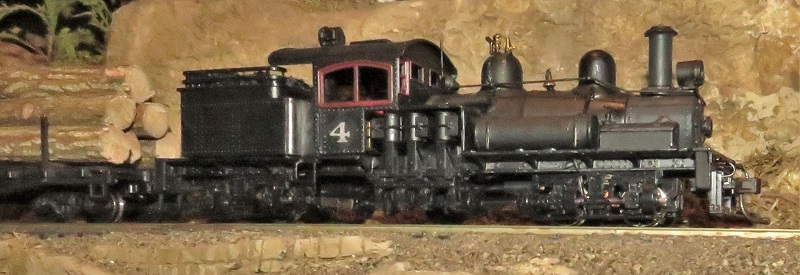

A few detail parts and some paint made for a model that looks good by the standards of my layout. Here's the "good side" of the Shay:

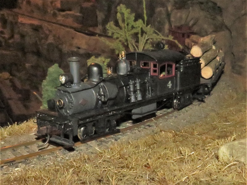

The left side of a Shay is less scenic, but here it is on my model:

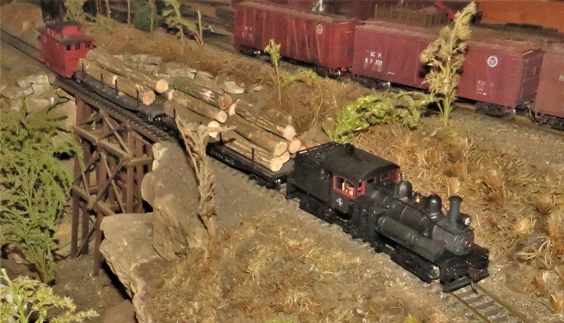

Here's the beast with a couple of loads of logs behind it:
