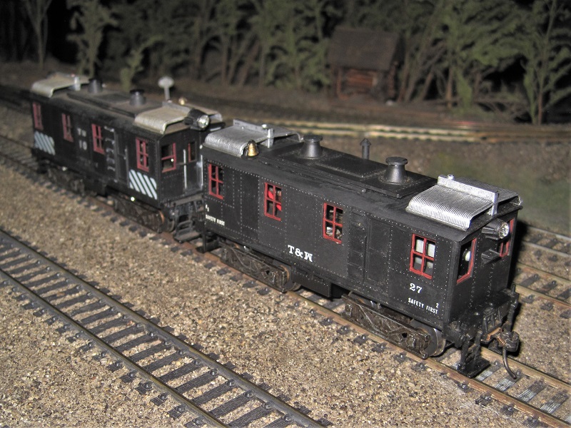

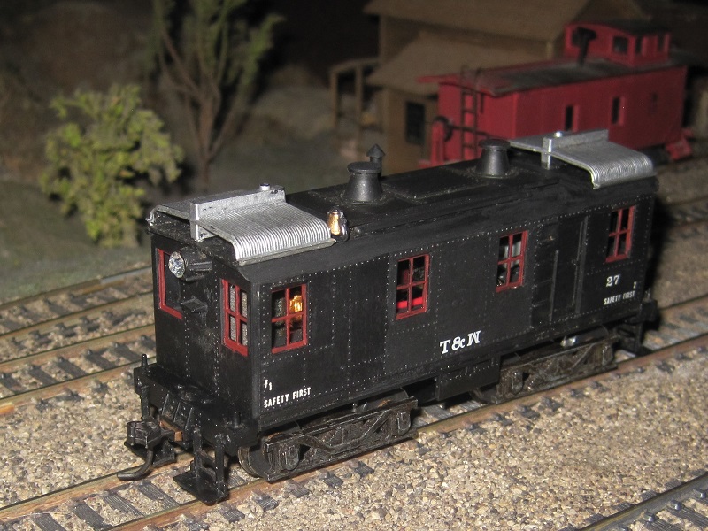

A while ago, I ordered some nickel silver wheels for the good one and for a Trains Miniature Alco FA. They were sold by the dozen, so to get the 16 wheels I needed, I had to buy 24. I put the 8 extras on the spare box cab. While I was doing that, I wondered if I could get it back running. I did, and I relettered it for my railroad and did some other painting. Here it is, fixed up.

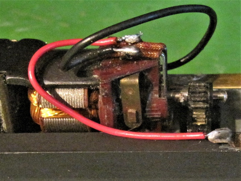

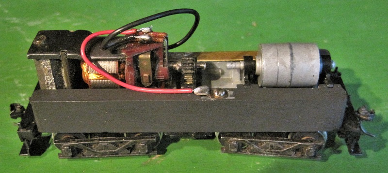

I put a ferrule on the split gear, but the thing was still obnoxiously noisy because of the scrounged motor which was a rough running 3-pole motor, not a 5-pole like the original. I looked for the old motor, but couldn't find it, but I did find another MDC motor with a worm on the shaft. I popped that off and put the repaired spur gear on and the engine ran more quietly. I also painted the frame to hide it in the shadows.
Here's a better view of the ferrule on the split gear. It holds the gear together well enough to run like new.

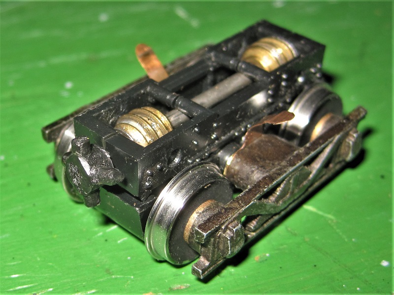

There are ball and socket universal joints between the frame and the trucks. One ball split, long ago, and I cobbled up another out of plastic sprues. This ended up on the spare engine, which in its present "good enough to use" state runs just fine with it, even if the thing is not precisely made.
This fixed up engine (formerly spare parts) has a speed range close enough to the other to run together double headed. Here are the two, together:

I had that trouble, now I might get it fixed. What exactly did you
use a ferrule? Engines look just magnifcent.
use a ferrule?
Originally posted by Chops124 - October 21 2021 :  9:20:42 PM
I had a piece of an old telescoping car antenna, but that's just a brass tube with some plating on it.
The gear is much longer than it needs to be, so I just trimmed down the last 1/16" or so to the inside diameter of the tube and pressed it on. It turned out a little loose, so I shoved some little stubs of wire into the tube as shims to tighten it up. I used a jeweler's saw to cut the short ring out of the tube. When I was done, there was still enough of the teeth left to engage the next gear down the line.
