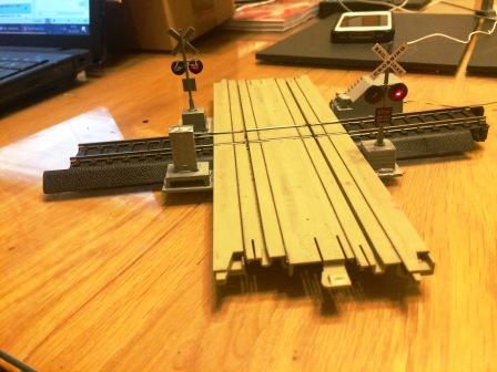

This is the original BUSCH plastic Wig Wag set with the flasher unit and dummy switch box mounted on a peice of Verro Board and placed under the crossing. The two lights on each stalk flash alternately.

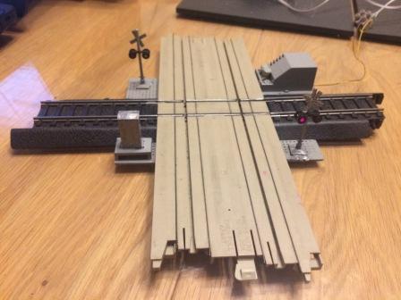

This is the second unit, that has now been rebuilt with the cheap Chinese metal Wig Wags bought from e-bay.
I have wired these to the original BUSCH flasher. They also flash alternately.
Both units are switched on and off by reeds mounted in the track as the train approaches and then leaves. The two modules that house the relays also feature a Faller Synchrnus motor that powers a drum that operates a Faller bell. This gives the customary 'ding ding ding' as the train is approaching and passing over each grade crossing. I place the relay and bell underneath the table directly below each crossing as they are too big to mounted on top of the table!
These units are for temporary loose-lay type layouts mainly done at shows, but sometimes by taking over the dining room!
