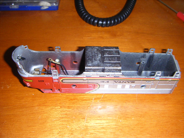

I got the motor running. It'll need a thrust washer to make it run like new, but that should be no problem. It binds in reverse. The post office managed to destroy a lot of the plastic parts, but there's a train show here next week .. I'll see what I can find there and if nothing else, I have a spare MU!

4 ladders were broken off, both couplers which were going to be replaced anyway were broken off, both horns were broken off, 2 side frames were broken, the shell was cracked and the weight had come out and was loose in the box.
After an hour, some toothpicks and Quick Grip glue, and overnight to set up, you can't even tell where the damage was. This engine will rise again

Oh, and now the motor is running like new after disassembly, cleaning and the addition of a brass thrust washer on the motor shaft & a lube job with Dextron transmission fluid.
Next, an LED headlight, couplers and I'll see if I can find side frames at the train show next weekend.
