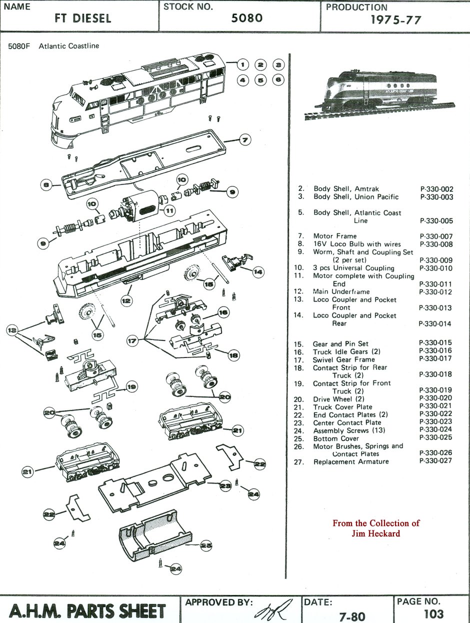

If it's Kader, It's most likely early pre-pancake drive Kader. I don't know of any drawings for the GP30 or the Bachmann U-boats, but the AHM FT was built by Kader and had the same 8 wheel drive.
http://www.hoseeker.org/AHMRivarossiassembly/ahmbuildersbiblepage103.jpg

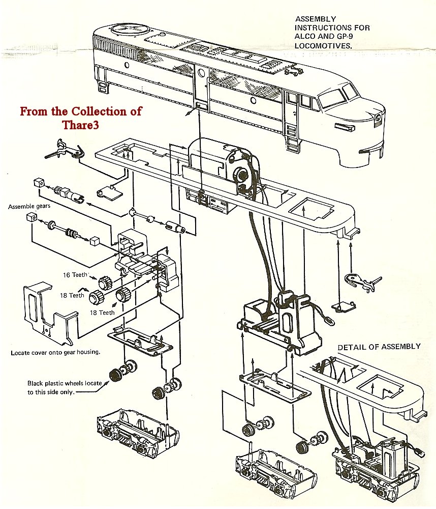

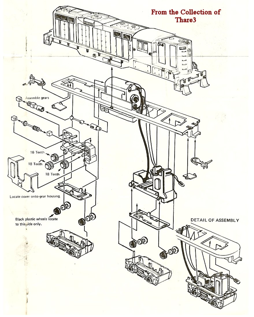

I believe the 70's GP9 and FA were Roco made. The design more closely follows 70's Roco practices like those made for Model Power (diecast frames & trucks, and those snap on plastic truck halves), not Bachmann's.
http://www.hoseeker.org/lionelhoinformation/lionelhopa1diagram1974.jpg
http://www.hoseeker.org/lionelhoinformation/lionelhogp9diagram1974.jpg

FA shell is the same old Hobbyline shell from the '50s and the GP9 shell is the same 1959 Lionel tooling/Athearn clone with the cab upgraded. U18B was a new shell made to fit the GP7 frame - and it too is much an Athearn clone, with the same too-wide hoods. All were made in the US by Lionel before going to a drive with the same pancake motors as the GP30; not sure if the shell tool moved to Hong Kong but I suspect not since none have appeared in any other lines.
In fact, when Lionel introduced the RailScope, or whatever they called their primitive version of a train with a TV camera in it, they brought back the FA tool for the HO one - and used a drive with Blomberg styled trucks under it.
Roco items are marked Roco, made in Austria, and in the 1970s Roco made it's own FA sold by Model Power.
I don't have the Greenberg Guide Vol. 2, but I've browsed it before. Some of the frieght cars were made by Roco, and some by Kader. Others were made by Lionel themselves.
It's certainly possible the drive clones existing Roco engines, but even the coupler mounting differs - whereas in the C424 made for AHM, you can see the similarities in truck sideframe design and they used the same oddball couplers as the original FA2/Shark drive used.
FWIW, the Greenberg Guide To Lionel HO Trains Vol. 2 1974-1977 may have a GP30 diagram in it, it's noted as having diagrams for some engines.
Personally, though, I'd toss the pancale and put some later drive under the shell if I wanted to operate it.
